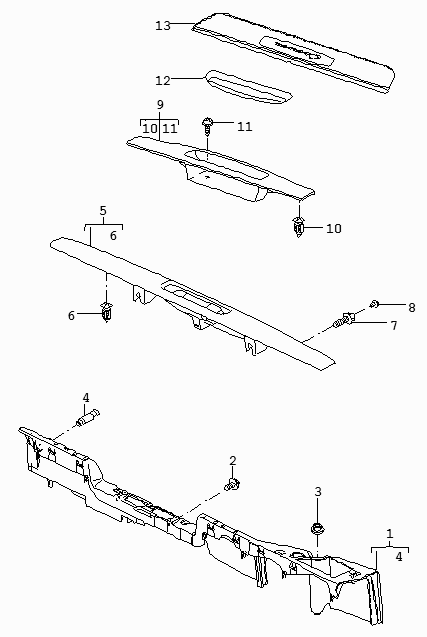

Thanks Loren. My biggest concern is the plastic trim on the driver's side door sill that houses the two switches for the front trunk and rear boot. Do you know if this plastic trim just snaps into place or is fastened down with screws?
It is my understanding the that the door sill tucks under the the rubber seal and plastic trim mentioned above. Do you know if my understanding is correct?
