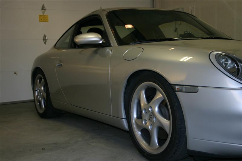

Ok here's the update, works great on 99-01.. pics of my 01 on X74 suspension..
Did you get new struts or did it just bolt on what you already had? Any impressions besides the ride height? Installation cost? Did your dealer do it?
