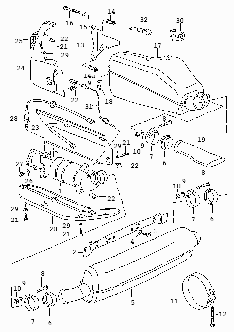

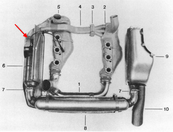

  Loren said:
I have never removed the O2 sensor (see red arrow) - but it sits on top of the catalytic convertor (item 6).
Item 28 in this diagram
