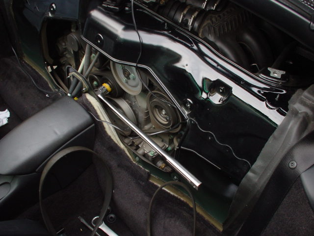

Loren has the instructions. The idler pully has a lot of tension since it is spring loaded. If you are strong you can do it with a 27mm combination wrench. I use a 2' breaker bar and a 27mm socket for more leverage like you see in the first picture. Rotate the nut clockwise and pull the old belt off.

I know it is 24 mm because I took this picture of my largest 36 mm socket and the correct 24 mm tools before I did a second belt change for a local Boxster owner. My original pictures show my 24 mm combo wrench and socket.
I ran into the same thing when I did the polyrib belt on my (now departed) '99 C4. The manual says 27mm and it required a 24mm..... and I ended up using a 15/16ths socket on a breaker bar.
