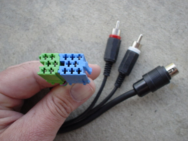

The changer wiring harness should have a green and blue plug. Blue goes to C3 and green to C2, which should be next to a yellow plug that is C1.

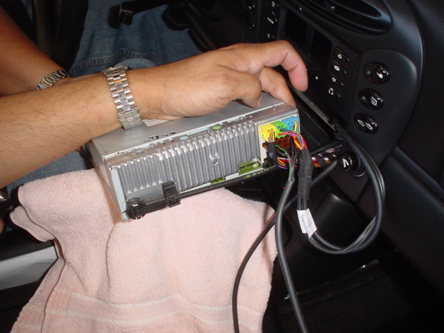

Next pic is the standard radio and you can see the green and blue changer plugs in.
Last pic is the back of a PCM unit, and I have put green and blue lines to where I think the changer plugs go.
If my PCM1 pic is correct and you already have something in C2 and C3, then do you have aux-in or a phone or something?

The changer wiring harness should have a green and blue plug. Green goes to C2 and blue to C3, which should be next to a yellow plug that is C1.
Last pic is the back of a PCM unit, and I have put green and yellow lines to where I think the changer plugs go.
thanks toolpants...it was my mistake. i didnt realise that the blue and green plugs fit next to the yellow plug...i just didnt give it enough attention before asking for help :oops: ill connect it up tomorrow and let you know how it works
thanks again for your help. :cheers:
Ok.
If the combined green and blue plugs will not go in, then remove the yellow plug and combine it with the other 2. Then plug in all 3 at the same time.
