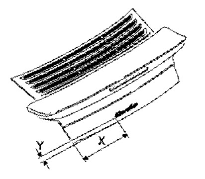

As the TT Service manual shows... logo placement is the same "centered" layout as the Carrera 4S.
1. Find the middle of the lid.
2. Position logo Carrera with the dimensions A = 185 mm and B = 31 mm on the rear lid and affix.
3. Position logo S with the dimensions C = 185 mm and B = 29 mm on the rear lid and affix.
4. Insert logo 4 in the external cut opening arrow of the logo S.
Removal is usually dental floss and a heat gun (or warm sun). Clean surface with some 3M adhesive remover and then atach the new logo.
