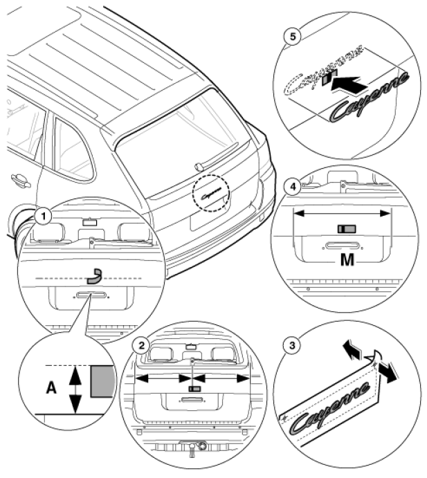

I know there are templates in the 911 and Boxster sections for the installation position of the rear logos but I can't find one for the Cayenne. My dealer says they eyeball it, I find it hard to believe that Porsche hasn't documented the logo placement in detail.
Does anyone have that information?

1. Marking the middle of the cover.
inset 1 - Apply an adhesive strip which can be written on with dimension A approximately in the center of the cover, parallel to the edge of the cover.
inset 2 - Determine the center between the outer edges of the cover and mark on the adhesive strip.
Step 2. Sticking on the logo.
inset 3 - Remove protective film.
inset 4 - Determine the center M between the outer edges of the license plate cover.
inset 5 - Align the logo using the adhesive tape marking and press it on firmly.
Distance from logo to edge of the cover A 85±1 mm. For all types
