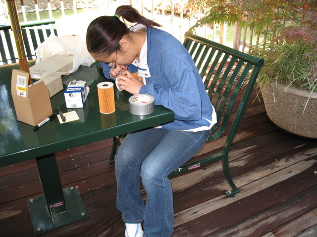

Next I'm going to attack some filters. It looks like from your pictures that the WIX filter has fewer pleating than the others. How does the amount and type of filter material affect performance? I would think the more the better. Back to Wal Mart, I hope they don’t mind if I cut a couple of Filters open. :D
Before the Wix filter was put in I had my office assistant count the number of pleats for the 3 oil filters shown in message #2. Then I did it and had her do it again, just to make sure. Somewhere I have the numbers written on a piece of paper if you want them.
The number of pleats is a rule of thumb. You also need to factor in the quality of the filter media. Wix publishes their specs on their site and it looked good to me, 28 microns. I was never able to find specs for the other 2 filters shown in message #2.

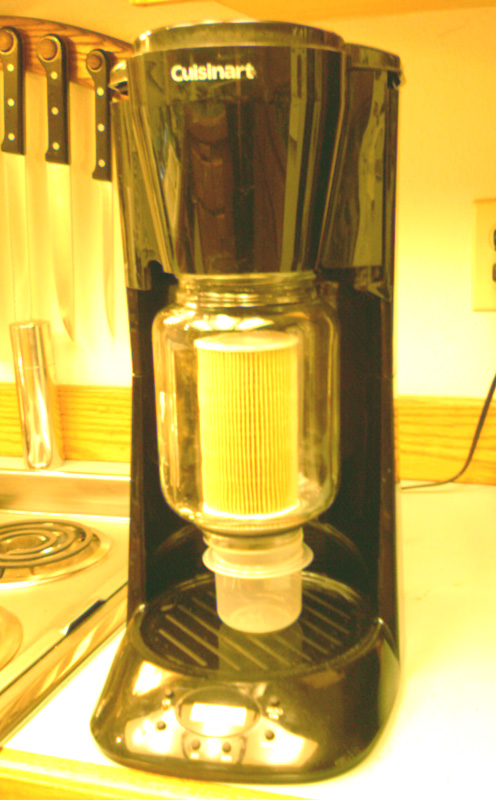

I was planning to also run some test on the other filters, since WIX is the only one with published specs. So I have modified my coffee maker to take P filters and will see what comes out. :lol:
