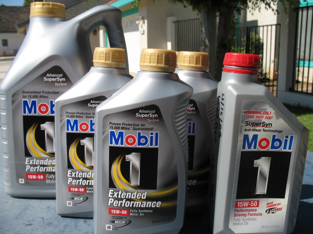

Looks like Mobil 1 15w 50 has been discontinued and Mobil 1 15w50 Extended Performance is the new substitute which comes with a yellow cap. Is this oil ok to use, just want to make real sure.

Either is fine in warmer climates or you can use Castrol.
I used the original 15W-50 red cap for 7 years in my Box.
When it was discontinued I investigated the EP gold cap line, including the 15W-50 EP.
Just bought 9 quarts of 15W-50 EP for my 60k oil change that I need to do.
Guess that if I put it in I will not go to Porsche heaven.
Mobil 1 15W50 EP exceeds the API classification required in the Porsche owners manual - you are good to go.
Used it in our 911 for 2 years - all is well.
