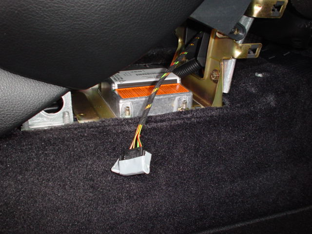

If the fuse blew because the cell phone connector shorted to ground then you can place some tape on the end of the connector.
Porsche started doing this for model year 2003 with the 986.
