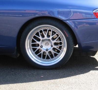

And if so are you having any issues? I have been given a pair of Michelin Pilot Sports in pristine condition and would hate not to use them. Next to some old Bridgestone RE730's I have that are 265/30/18 there is barely a discernable difference. The Michelin's are very slightly taller.
Thanks in advance!
I think you will find that you need 285 30 18 - it won't be right with 35's
I have 285's and they are fine - woth good wheels they are the business.
Rolling Circumference = 2063mm on the /35 and 1974mm on the /30
Overall Diameter = 657mm on the /35 and 628mm on the /30
IMO I would not use them as they will affect your speedo reading and geometry - not sure to what extent but why take the risk ? If you're car is under warranty, then Porsche will see that they are not 'standard' and not pay out if you claim on anything related...
