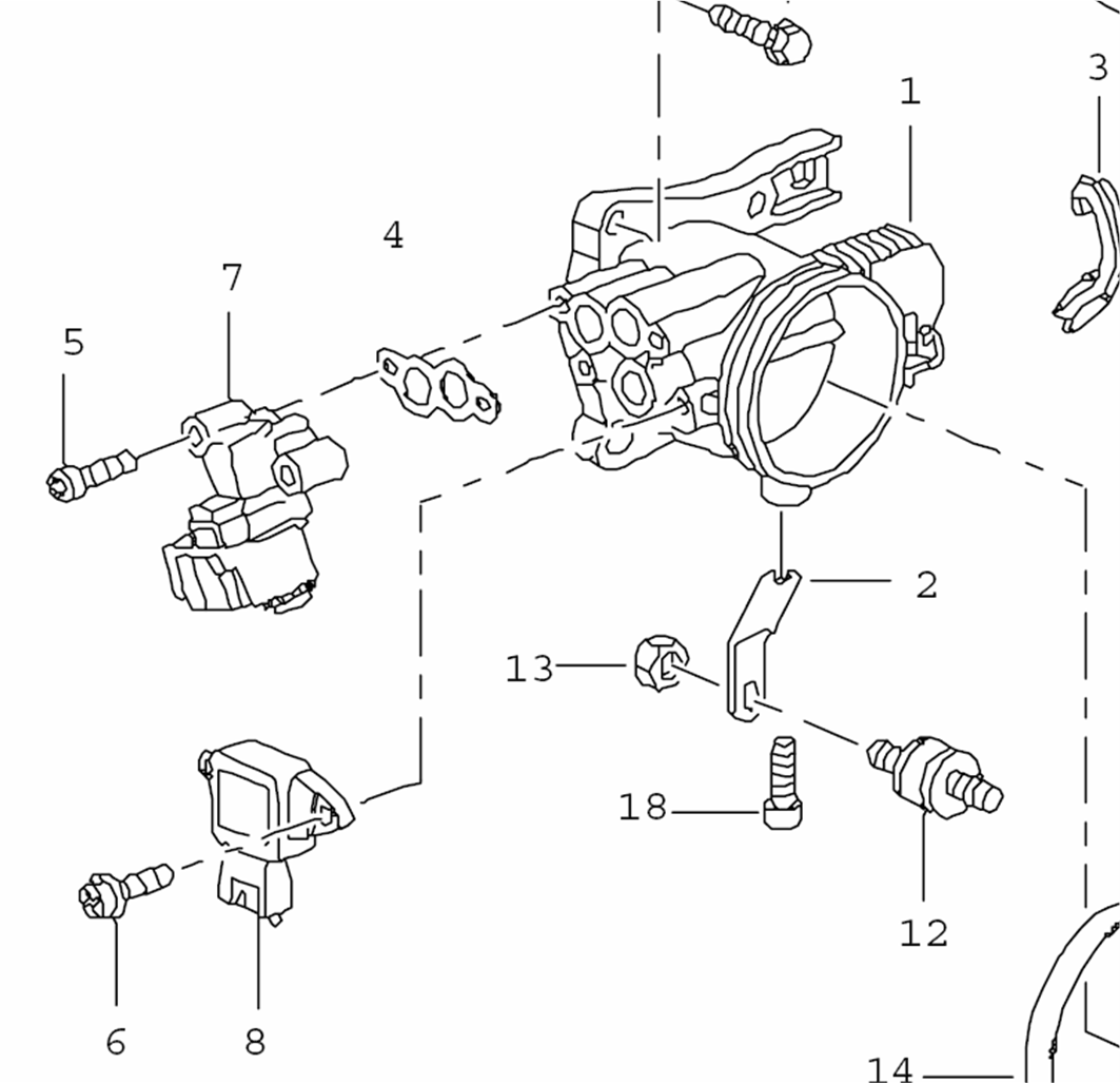

Try removing and cleaning the Idle Control Valve on the left side of the throttle body. Spray with carb cleaner. This is assuming you have a C2 and not a C4.
....well according to the dealer you are right. They want to replace the idle control valve. They quoted me a price of $940 parts and labor. Does that sound right? I normally go to the dealer in Torrance and trust my service advisor there but I didn't want tow it so far since the Beverly Hills Porsche Service Center, which is in Santa Monica, is like 10 blocks away. This is my first time there.

The Bosch part for the ICV is less than $200 and you can get it from Autozone. Install takes 5 minutes. I would first remove it (2 screws) and spray it with carb cleaner. These sometimes gum up and do not operate correctly. You cannot hurt it by spraying.
Phil,
If it is the throttle control valve, it may be more of 10 minutes for me. The part for the 1999 is not expensive either, since it is not a potentiometer. I have done the job before, used carb cleaner also to clean the crud that accumulates on the throttle body butterfly as well as removing the switch and cleaning it. Here are some pictures, 4 bolts to remove the throttle body (and be careful with the paper gasket behind it), put on a bench and spray the cleaner on it. I used an old tootbrush too to remove the crud.
7.5 ftlbs of torque on the bolts. Of course, you got to take out the airbox and hose to get to the throttle body.
That is assuming they are calling the throttle control the "idle control valve". I did not see any "idle control valve" in the manuals that I have.
Item 7 in your diagram is the Idle Control Valve. Item 4 is the fragile paper gasket for it.
Only MY99 C2 996's are non-egas and have the ICV. C4's and all later 996's have egas so they do not have the ICV.
