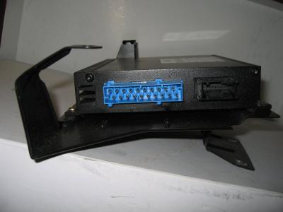

I added the PNP rear speaker kit and a small 30w 2 channel amp which fit under the passenger seat. Changed out the front dash to MB Quart 4" and 3/4" components, left the door speakers stock, going to put bass blockers on them since I added the small kenwood powered sub which fit behind the passenger seat with only sacrificing about 2" of legroom.
Can you post a picture of how well that sub fits behind the seat?
Has anyone had any issues with upgraded components turning off and on randomly? My MB Quarts in the dash keep cutting out, I thought it was the crossovers so I used other ones and it worked for a week, but yesterday and today they started cutting out randomly again. I suspect the factory amp may be overheating or can't handle the better speakers, but the amp isn't hot. I've checked all connections, can't figure this out. Just about ready to get a new 4 channel amp for the dash and rears, and an Alpine head unit for my ipod. Any thoughts?
Interesting approach on the sub. You could probably even make some king of bracket to lift it up 6" and fit it behind the middle of the seat and still have it mounted to the board on the floor. I might look into that for myself.

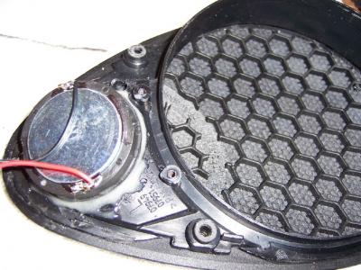

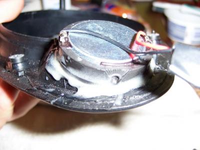

2- 95% finished installing the huge magnet Boston s45's (4" coax) in Dash a'la Jinster. Mounting depth was over 2.2", and sure enough...left side dropped in fine...but the right side nudges against the bolt head... <_< . Drops in all the way if I twist it a tad, but grill does not lie perfectly flush. So..I will Dremel off 1/8" of an inch off the bolt and/or speaker magnet, and should drop in just perfectly.
What I did:
- I Broke apart the plastic Nokia speaker bracket to use it as a mount, like Jinster. 10 minute job, used metal cutter scissors.
- To drop the s45 fit into the Nokia bracket, I had to clip (same metal cutters) the 4 mounting tabs almost completely off, and left just a bit so they fit snugly. Too snugly as it turns out, had to Dremel the inside perimiter of the Nokia braket a tad. And, I cut a bit too much off some of the tabs, so Epoxy was needed to secure the criver in the Nokia bracket.
- I dropped some thick epoxy on each tab, and screwed the whole thing back in with the standard 3 screws.
- I reused the existing connectors, soldered female part to speaker s45 wires/clips.
As others have indicated, replacement sounds GREAT.
What I learned:
- 2.2" is pushing it if you don't want to grind the bolt or magnet. 2" depth replacement drivers eliminates this problem.
- Be careful clipping the tabs, to leave enough so they fit snug.
- I wanted to do this beause I enjoy DIY'ing, and challenged myself to fit the Bostons. If someone wants less hassle, VFBox's adapters are probably a simple way to go than clipping, dremeling, etc...
- Thick GEL epoxy (2 part) works well and does not spill where we don't want it to.

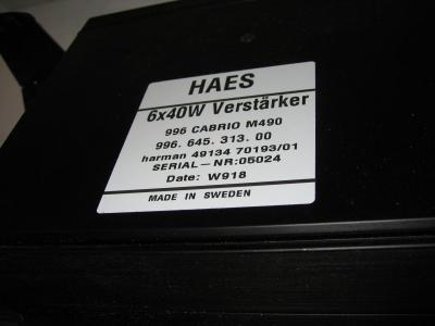

PS: Does anyone know if the 6x40 amp does NOT have the high pass crossover or filter that I assume the 4x40 has? (Which would be why only low's go to the doors) Reason is, I hope all 6 channels drive all frequencies, so I can get full range from the doors. Thanks!
Ok, so I found the problem with the dash speakers going on and off randomly. The left 4" speaker positive terminal touched the metal in the dash once in a while, I found this by accident. I redid all of my connections, had the wires all zip tied together neatly and tucked away under the dash, put the right speaker in, then the left, and as I tightened the 1st screw, the sound went out. It was then that I saw the terminal touches part of the metal in the dash. So I covered all the terminals with electrical tape and it's working fine.
On the Haes 4 channel amp, the door speakers are brown, brown with a stripe, green and green with a stripe.
