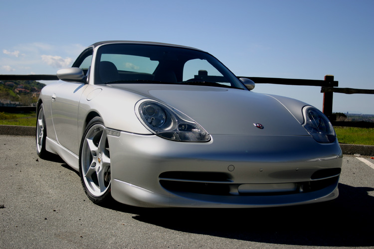

Well I really don't like my headlights because of the amber indicators... I would like to buy new halogen ones but with clear transparent indicators like those :
and not like this one (that is clear but does not seem to be transparent)! :
