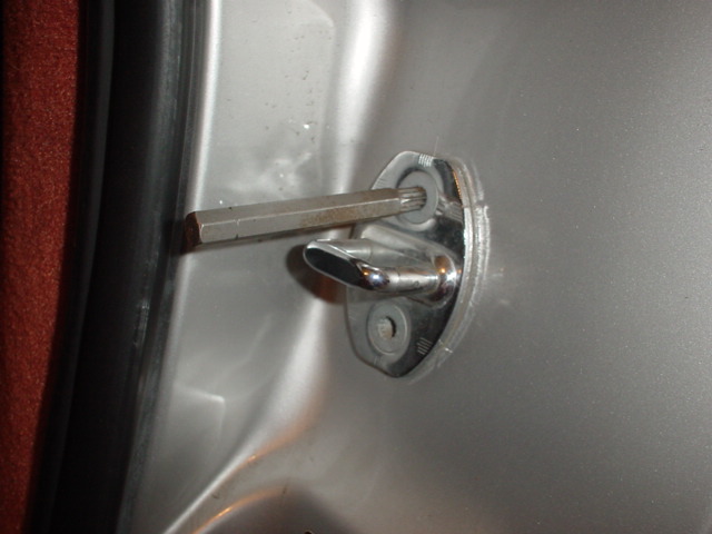

If it has 12 points then it is what I call triple square, also known as XZN or fluted allen, like my pic. On my car it is 8 mm. Torx has 6 points, not 12.
Never seen it at Sears.
Jeff, as usual, you're the MAN! Many thanks.
