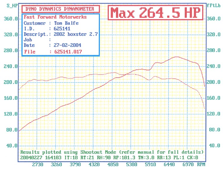

Here is my dyno pull from the other day. I'm going to the drag strip again tonight, our PCA region doesn't have any auto-x this month and my next track session is at Sebring on March 27th. The drag strip isn't as fun as a road course or auto-x, but it beats sitting at home watching Speed channel.

mr TheLion,
I don't see a muffler chip and Evo as able to take you from 181.7 to 264.5 HP, and I don't know the adjustment factors on the Dyno Chart.
Do you have dyno numbers that compare RWHP to RWHP?
seems like a huge gain....great if its true but chassis dynos will always have some bit of error

I have to agree with rxbox and adsach. Your 264hp number seems very unrealisitc. My guess is at most a 15-20 rwhp gain from the chip, intake and muffller. And that's with running 93 octane in cool, dry weather; not hot and humid FL weather. However, since I'm new to the Box scene I could be wrong. :) I'm basing my experience from my previous (but similiar) car, the E36 M3.

That's not 181 to 264 at the wheels, it did 225 at the crank, stock, and 265 with the mods for a gain of 40 hp, that's with the sport cats, headers, muffler, EVO intake, and custom chip. It was an expensive as hell way to find 40 hp. My friend did the same thing to his Boxster S and he's making 302 hp at the crank, same cost to do it.
