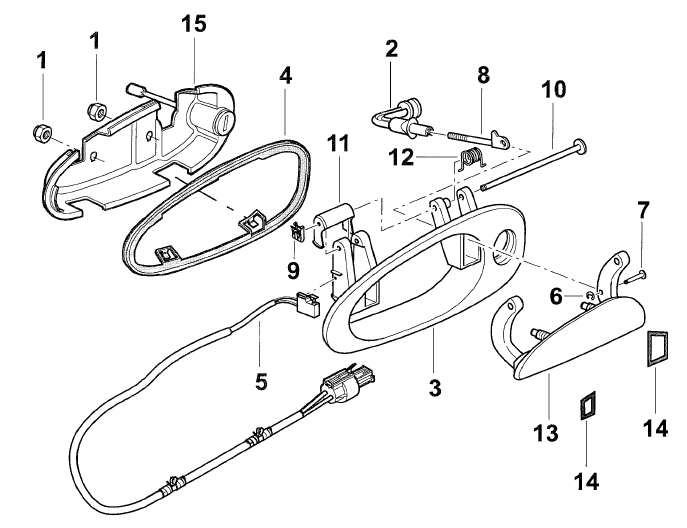

Is there some kind of switch or sensor that tells the alarm system that the door is open or closed? The wiring diagram shows switches for "door contact," "lock," and "safe contact" (what is that?), but I don't see any PET parts listings for any door switches other than the handle microswitch. Could that be the one?

Item 5 - microswitch
Thanks, Loren. That's the first thing I thought of. But would a failed microswitch precipitate the other faults I'm seeing? (e.g, alarm error double-beep when locking an open door).
The handle switch *seems* to work OK since the window drops when I pull it and the window goes back up when I release it. The ringer is that the system doesn't appear to know that the door is actually open so the window should stay down. Is one of the functions of this microswitch (key #5 in your diagram) to know if the door is open or closed? If so, then I agree with you and I'll get a new switch.

Tom,
The microswitch Loren refers to is the switch to activate the window lifter. The switches to detect door closed, locked, key turned etc are all in the door lock module. Module being the operative word, all the functions are carrried out in one lump of plastic. Part number 8N1 837 015C. To the eagle eyed, this part number is for the door lock of a LHD Audi TT. Being electrically minded, I would open the module up to see what was what, but if you haven't the confidence, I'd verify the part number with your OPC and see if you can get it cheaper from an Audi centre.
