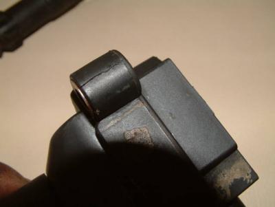

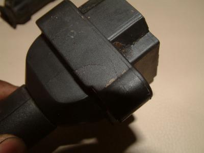

I took just 2 of the ignition coils off today on bank 1 I think (drivers side) and took some pictures
would small cracks in the side like this really cause problems??
Many thanks

Hey all,
Well I fitted my new coils yesterday. All 6 of the old ones had verying size cracks in so the new ones were a good investment I guess.
Bad news though, Still misfiring alot.
One thing I noticed this morning as well, when I started it up from cold after a night of standing, is a huge puff of blue/white smoke coming out the exhaust, this then turned more to a white smoke as it heated up, then a few minitues later it calmed down.
Loren, Tool Pants, anyone, any idea's??
many thanks

Are you sure the connectors are all properly seated?
Post your fault codes please (all of them).

Yes, make sure the connectors "snap" into place.
I guess a bad enough leak at the oil separator could cause oil fouling of the plugs. But your cracked coils needed to replaced too.
