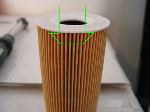

MY 2002 996 oil filter installation question: When the filter element is installed on the engine, does it slide all the way up into the motor, or does it sort of hang in the air after "popping" onto the engine portion noted in green in the pic below?

Thanks, Richard... I understand all that you say, but my question was regarding how the filter actually installs to the motor.
What I came to realize is that once installed to the motor(without the filter housing), the filter element sort of hangs in mid air. Meaning, it doesn't get crammed up into the motor (out of sight). The filter housing then installs over it. The filter element "pops" onto the motor and then hangs, later to be covered by the housing.
I was working quickly and never saw the "spindle/spring element" that supposedly latches onto the filter element. I suppose it was inside the filter housing, but I didn't notice it.
I really don't understand the question that you are asking.
The filter does hang onto the engine block just like how it looked when the housing is removed.
There is no spindle on the oil filter housing. You just push up the paper filter the same way you pulled the old one out. Then you screw tight the housing. The housing will tighten the seal of the filter to the engine block.

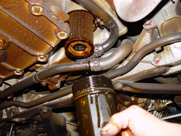

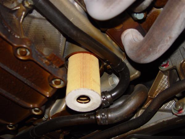

The first time I was asking myself the same question....
....you install the filter on the engine like the picture...and when you tighten the filter housing to the
proper torque you will hear a small crunch....that's when the bottom part of the filter mates with the housing... I'm sure someone else can share the "crunch experience"....
Pictures from Oakland.
Jeff, thanks for the pics. I was tired and moving fast... :eek: djantlive, thanks for the reply.
I installed the new element and then the filter housing over it. As I tightened the housing I felt the crunch that speed123 described. That made me wonder if I had pushed the new filter element up high enough into the engine. So, I took the filter housing off again, and this time the filter element came off with the housing, and the filter was sort of stuck in the bottom of the filter housing... like something was holding it in place (this must have been the spindle assembly mentioned in Loren's DIY).
So, I took the filter out of the housing and reinstalled it to the motor after making sure that it couldn't be pushed up any further. The filter element just sort of hangs in mid air. Then, I reinstalled the filter housing cover, felt the slight crunch again, and continued to torque it down to spec.
Apparently this is all part of the process and normal. Thanks to all.
