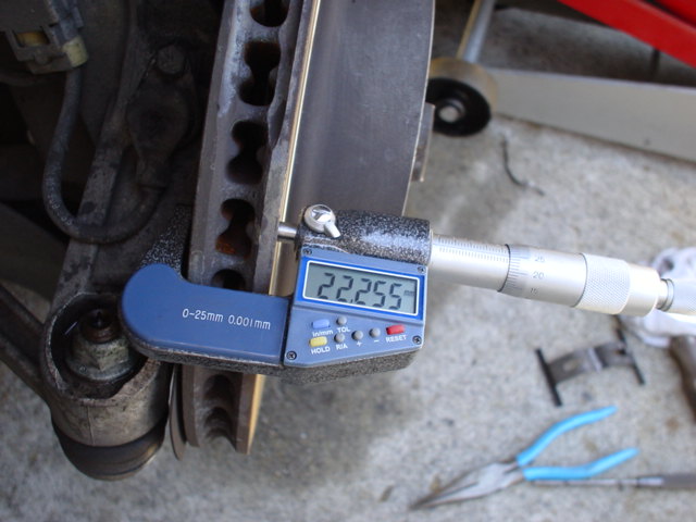

Being that you like to DIY measure the rotors with a mic and see if they are within spec. Don't have a mic? They are not expensive and it is a tool that is indespensable if you work on mechanical things. If they are still good you can take them to an auto parts store for resurfacing. This gives them a flat new type surface so your pads will wear in evenly and quickly.

:lol: wear limit is 22.00 mm
Is that for the S or non S or are they all the same? Thanks for this bit of info. I've been looking around for this for sometime :)
Boxster rotor minimum thickness limits (after any machining)
Front: 22 mm
Rear: 18 mm
Boxster S rotor minimum thickness limits (after any machining)
Front: 26 mm
Rear: 22 mm
Front: 26 mm
Rear: 22 mm
My front are at 26mm and for a moment, you got me all happy thinking I've still got 4mm to go. That is until your post on the 26mm for the S :(
Time for new discs I guess...
Thanks for the info though :)
