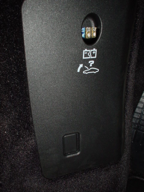

Have 2001 2.7 RoW LHD Boxster
Yesterday I noticed that the rear spoiler had not retracted automatically.
Here I see talk of a switch that will manually retract the spoiler; can't find my manual to locate the switch; is it in the fuse box

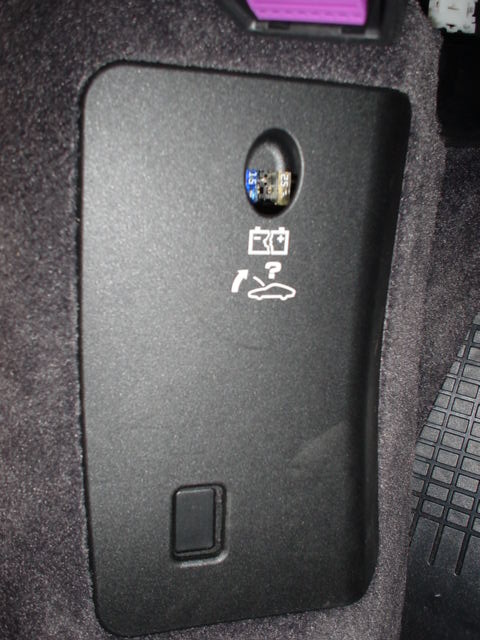

it's the switch that you can see through the fuse box cover, it's not a 1 touch down, you have to hold it down to get the spoiler to retract all the way
Uhh, where's your switch gone, Jeff??
S.
i'd wager he moved it to the dash and replaced one of the dead buttons with a spoiler switch :)
and it's labled "gt2 fuse cover" so he's being sneaky!
Thanks for the info; the spoiler went down automatically next time out but nice to know for the future
