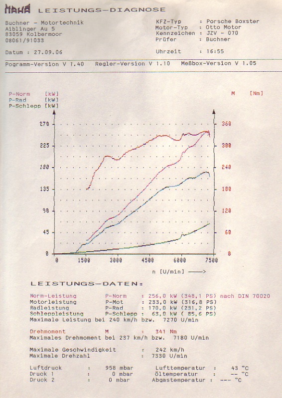

Ok, car is back from the dyno. Meanwhile had to make an engine replacement, covered by TTP's insurance (engine blown while on the dyno at TTP's workshop). It is smooth as silk, additional 70 BHP is definitely a good thing :D Will keep you informed with more details, pics, video etc. if anyone interested.
