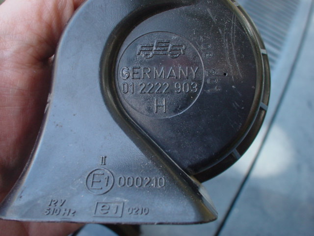

The horns are made by FER. http://www.fer-online.com/
The part number on the high tone is 01 2222 903. I assume this is a FER part number. I do not have a low tone to look at.
I would not be at all suprised if it is also used by Audi/WV.
