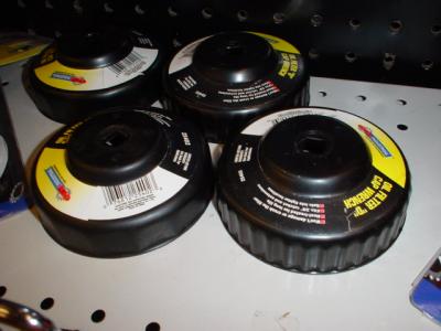

Oil filter cap style wrench. They come in plastic and metal. Get the metal if you can. It should be 74 mm by 14 flutes/flats.
This is what I use, the Wallmart special. They have number sizes, and I have the #7 for the Porsche. The manufacturer of this one is FloTool, and it is graphite plastic. I think it cost $4.

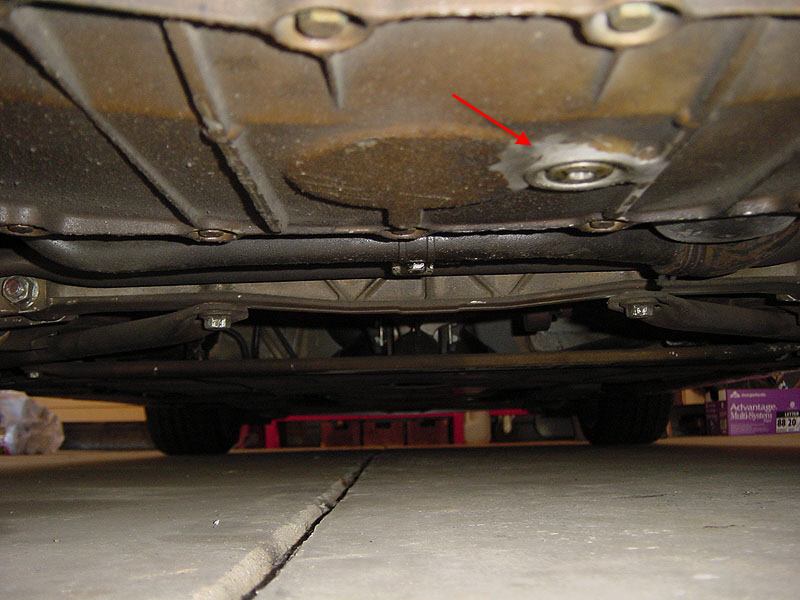

1) Is the oil drain plug difficult to locate? Can anyone post a pic of what it looks like/where it is?

1. Drain plug location
