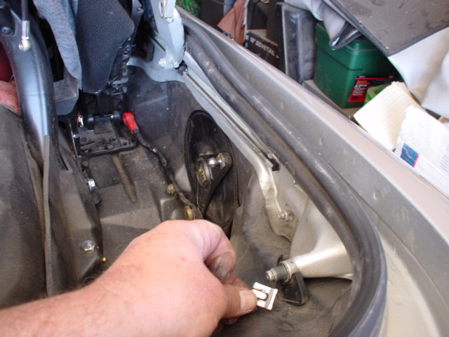

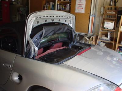

You do not need to disconnect the black push rods for the clamshell. They happen to be removed in the silver car because I was trying to fix the top drive. The top pushrods with the plastic joints are disconnected in the silver car for the same reason - fixing the top.
In the blue car all 4 push rods have not been touched.

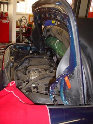

You need to remove this clip on each side then you can lift the clamshell to a vertical position. Lot easier to get to the top of the engine compartment in what I guess I will call an "extended service position."
