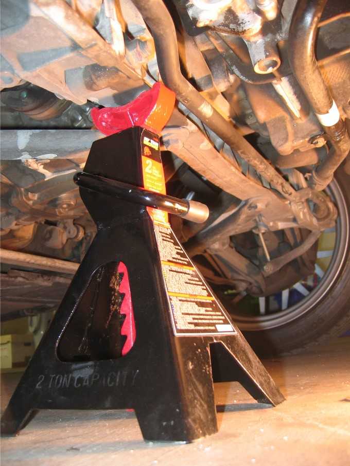

Jack the car up in the center of the cross piece near the engine, then put the jackstands where the factory jackpoints are.

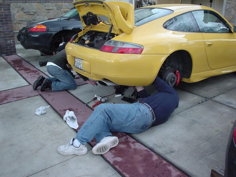

Tool Pants - This pic does show you what crazy (dangerous) things some people come up with to work on their cars....

If your installing the exhaust, you will want to jack it up from the rear. I usually put the jack pad under the center of the engine crankcase to raise the rear of the car high enough so that I can place the jack stands under the main suspension support cross bar member on each side, then lower the car until the support member rests on the jack stand pads...If you car is low, your floor jack may not reach far enough under the car to jack it up from the main support cross member, hence you need to raise it up under the crank case. That is what I needed to do with my GT3...Perhaps your C4 is not lowered and you will have enough clearence to get the floor jack to reach the cross member..

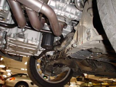

I know it sounds dumb but I look under the rear of the car and I see um, er, an engine. I have seen some good pictures of the underneath of the engine but I still don't know where to put the jack there.
I saw in one post the mention of a seam where the two halves of the engine join. But I can't see it.
I saw another that talked about using a flat 8" lip bt I can't see that either.
I guess I need to see a picture with an arrow or something.

I wonder it too, have seen underneath a couple of time but couldn't find a good place for supporting the jack!
it would be neet if anyone could post a good pic of the center point for the hydralic jack.

Loren, you sent me a pic (which I can't find) of the rear underside and you outlined the center jackpoint in a white square.
hey scouser, here it is in action. worked great. i used the stock lift points and used the cross member for the jack stands.
