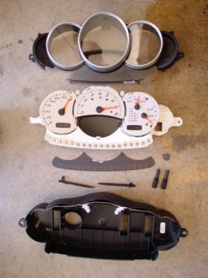

The knob stem on a new style cluster is easy to replace, if you can find a used one.
As stated, Porsche does not sell the stem, but does sell the knobs, but you should be able to figure out how to get the broken stem out of your knob.
You can see the stems to the left of the knobs in this picture.
