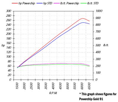

Please post your results. I am currently in the process of evaluating Revo myself and am very familiar with their offering. Just for fun, here is PowerChip's dyno. Doesn't look like any Boxster dyno I've ever seen. Can you say Excel?
Based on that it makes me believe that there is more hp lurking in that motor that Porsche is afraid to release. Why does the BMW M3 make something like 330 hp from it's 3.2 liter motor?
