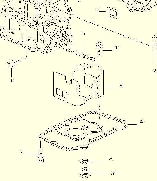

I don't have any details of the change - only that the parts list says to use the 997 number instead. Perhaps Carlos can take a pic of the two side by side. BTW... this in not the oil pan but the windage tray inside the crankcase (item 25).

The blanket replacement windage tray (for 3.4 and 3.6 liter engines including X51) is the now same part number as used on the 997.
997.107.243.00
All I can tell you is that if you look at the replacement parts list for standard and X51 engines it says to use that 997 part number for the windage tray.
The old number for the assembly (996.107.243.40) comes up in the price list but not in the parts list - go figure.

I tried ordering 997.107.243.00 and what came is the black plastic style windage tray that looks pretty much the same as what comes in the 3.4 and 3.6.
Any suggestions? I may just have to get the assembly # quoted below.

Did you try to order the old part number (996.107.243.40)?
Well that is my next option here after I return the other ones. I plan to order a 996.107.243.40 (that is the x51 baffles and a new oil pan). I was trying to order just the baffles/windage tray so I didn't have to throw out a perfectly good $170 oil pan (the parts for those btw are identical) but Porsche forces you to buy a new oil pan just to get the x51 baffles.

I just installed the pan with the updated baffles on mine last weekend. There is several more baffles in the system and a larger space where the oil pickup is. I found it onsale from SunCoast Motorsports for 199.95. I do not think this will hurt anything. With the additional baffles it looked like it would help.
Part number for my car was 996-107-243-40, I also purchased the adhesive sealant 043-204-35.
