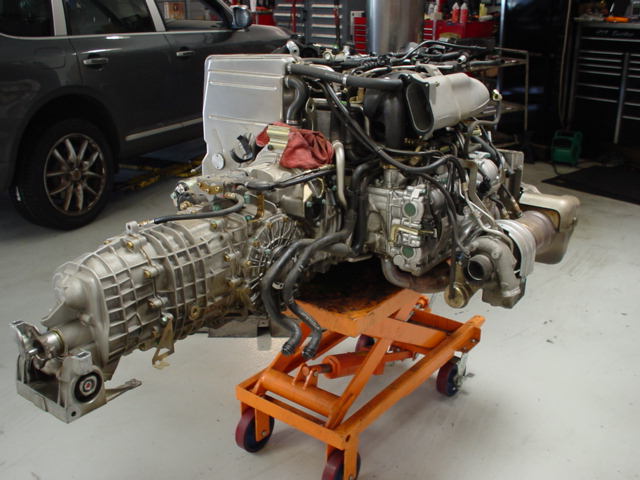

Here is what the new (remanufactured) engines look like. Nice thing is that they get all of the updates from the 2005 996 run.
