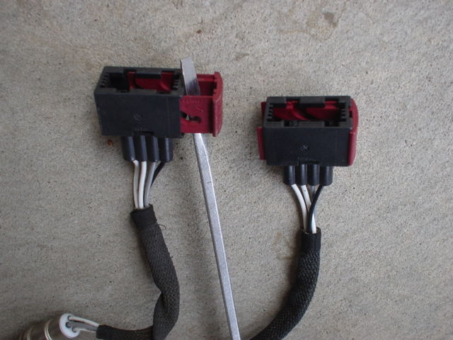

Sorry for asking a stupid question, but I can't figure it out and/or don't want to break something. How does one unhook the electrical connector when R/R an O2 sensor? It's kind of a flat oval thing with a tab on it. Does the tab push in or pull out. I also read somewhere that you push rather than pull to unhook it. Any sage advice so I don't break something appreciated. Thanks!
The 2.5L ones look so much easier. Here's a pic off eBay. I can't tell if you push/pull/lift or what.
OK. I figured it out. You squeeze the tab in while pushing the connector in. Then, it clicks and releases. The trick is to not pull while squeezing the tab.
