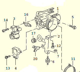

You will want to get some carburetor cleaner and a lint free rag to clean the throttle body and butterfly (1). You will likely want to remove and clean the idle control valve (3) too. If the (insides) of the valve does not turn freely then it may need to be replaced. To remove the Idle Control Valve just disconnect the electrical connector, then remove the two (allen head - I think) screws. Be careful to not lose or damage the paper gasket (16) that fits between the valve and the throttle body.

If your car is egas then it should look just like the pic above.
On egas cars there is nothing to disassenble. Just open the butteryfly and clean it throughly with carb cleaner.
