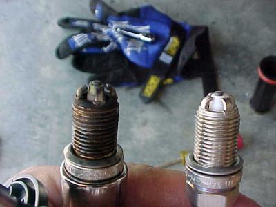

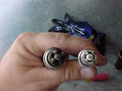

You should have the 4 electrode plug.
I have raised a similar issue on the Boxster side. In 2000 the 2.5 Boxster became 2.7 and the 3.2 S came out. The 2.5 has 2 side electrodes and Porsche says to replace at 30k. When the 2.7/3.2 came out Porsche switched to 4 electrode plugs but Porsche still said 30k. But for the 2001 Porsche says 60k. The plugs and engines used for 2000 are identical for 2001. There is no reason for it to be 30k on a 2000 but 60k on a 2001. I have asked the mechanics and they also cannot figure out the discrepency.
The plug in your car is the same as the 2.7/3.2 Boxster. We have replaced a few at 30k and the plugs looked almost like new. I consider the 4 electrode plug a 60k plug.
On the Boxster side there are reviews of the Bosch Platinum +4 plugs.
Here are some pics I saved from last summer, the new and the old plugs close up. Worth a thousand words.....
Izzy
