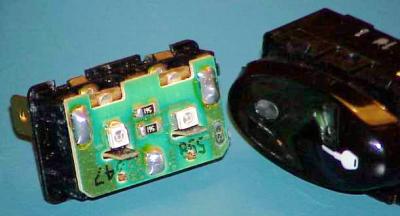

Like you, I found the glare from the red LED to be annoying in my '99 996 coupe. My solution was to replace it with a green LED I purchased from Digikey. It takes some careful soldering with a low wattage iron, but green is a lot easier on the eyes. It also seems more appropriate for indicating the doors are locked. It sometimes is a little hard to see in direct sunlight, so I don't think I'd recommend it for a 996 Cab., or a Boxster. BTW, I also tried an amber LED, but still found it a bit annoying at night.

The Digi-Key part no. for the GREEN LED is: 67-1365-1-ND ($0.64 ea.).
The YELLOW LED p/n is: 67-1367-1-ND ($0.64 ea.).
The LEDs are only about 1/8" x 3/32," so the soldering area on each side is miniscule. I would advise ordering more than one LED, in case you accidentally melt the device while soldering it onto the switch's PC board! Take note that the cathode side of the LED is denoted by a diagonal cut at one corner of the LED. You can easily see it on the right-hand LED in the pic. Each LED is sealed in a tiny plastic enclosure to keep humidity out until it's time to solder the LED in place. I used a modeler's knife to cut it away.
