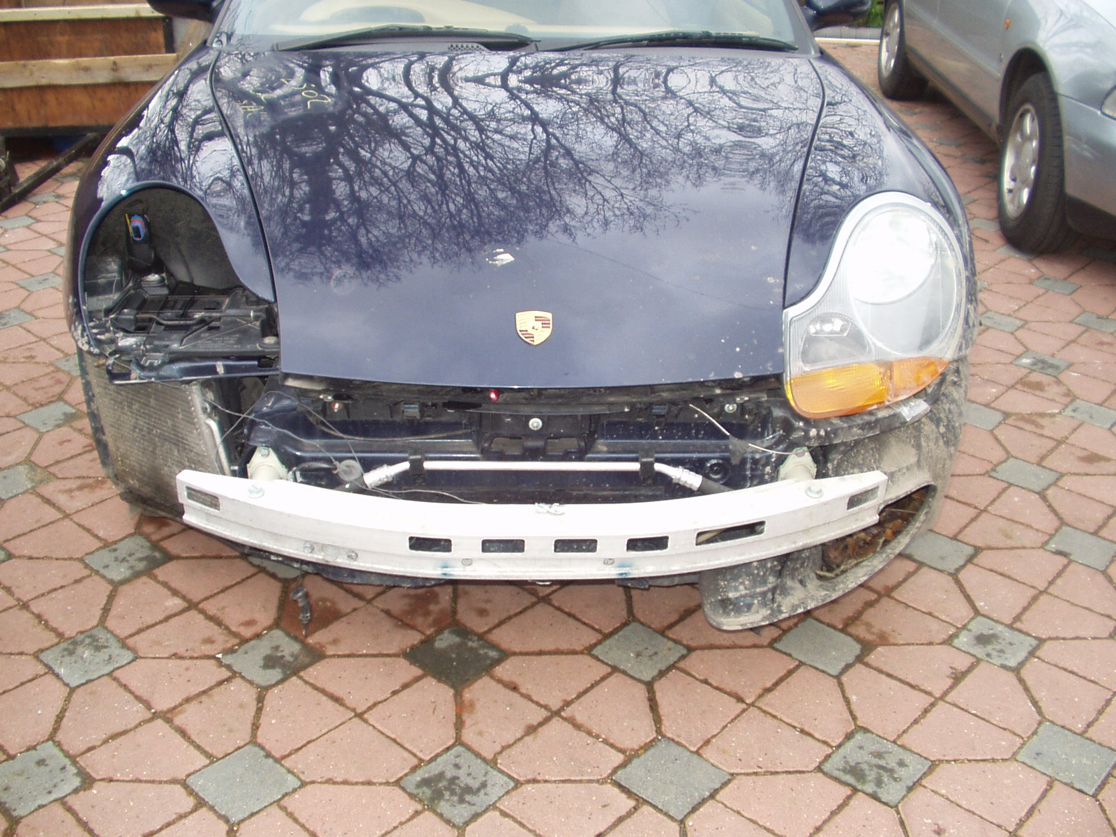

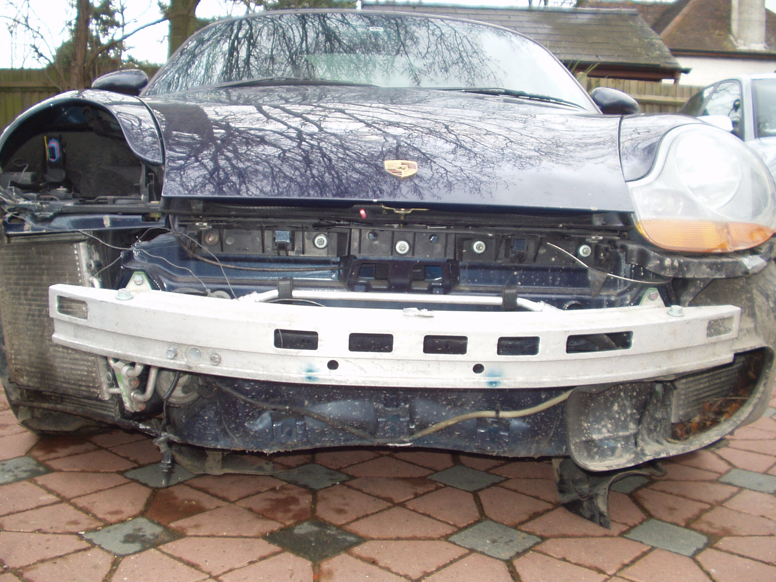

Car's history
Bought few weeks back as stolen recovered vehicle. On inspection it needed the following
- bumper (already sourced)
- new drivers side front light (found in front boot of car)
- side repeaters (sourced)
- drivers side air duct/guide (sourced)
- some plastic parts for bumper (grill/side trimmings - also sourced)
- new car radio (sourced cdr23 and 6 CD changer but unsure if cdr23 will work with 99 boxster)
best pics
