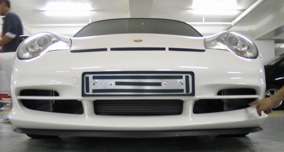

When you mention both front fenders - what parts are these? The front as I know the car has the main front bumper with a splitter at the bottom.. I have attached a picture
Sorry, Disregard question - I understand now what you mean.... oops :lightbulb:
