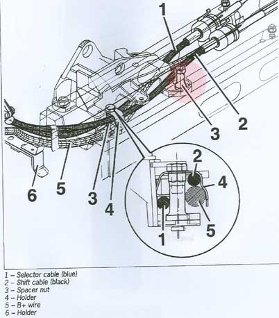

For completeness of this post. I tracked down what caused this. At some point the connectors on the transmission had come loose and were held in with tie wraps. Whoever fixed this had at some point pushed the cable hard enough to pop it out of the guide/bolt under the centre console next to the handbrake (see the red circle on the diagram .The cable had been sat on top of the guide rather than sitting to the side and was thus bent at a bad angle for the cable to slide. Over a period of time this caused the internal rod/cable to fracture. I measured the length of the broken rod and it was right over the apex of the guide.
Anyone who has had to pop back their connectors at the transmission end, might want to check under the console as a precaution.
