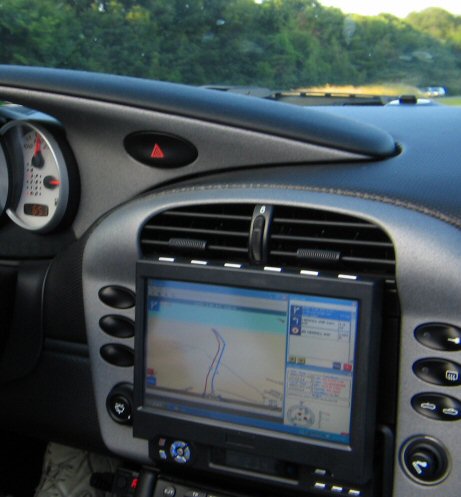

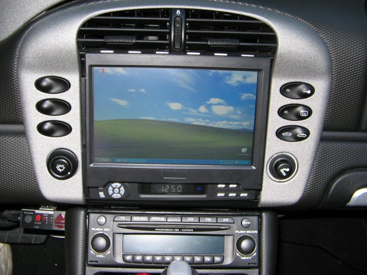

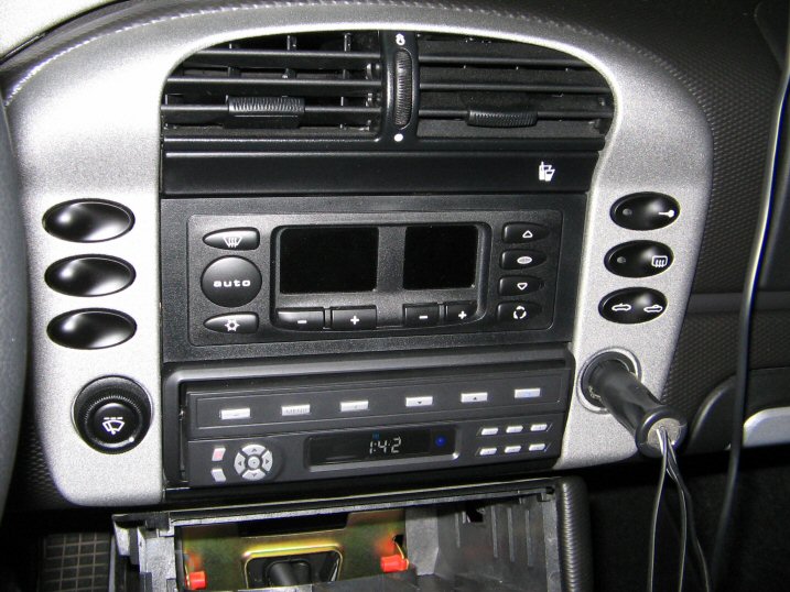

IMHO the problem with the Mac is the lack of software - there really isn't any decent GPS software for the Mac which is probabky the single biggest benefit in having a computer installed.
I went with a PC instead, it's installed in the front trunk running off a DC-DC power supply and connected to a motorized 7" VGA screen in the dash. Pretty much everything is driven by the touchscreen but there's also a small keyboard in the glove box if needed.
Screen closed:
Screen Open:
Screen Running GPS:
Assembly and installation wasn't hard but requires a pretty good knowledge of PC's, overall cost was probably less than a standalone GPS unit. The only down side is the lack of a decent way to get sound in to the MOST head unit - I have to rely on an FM Modulator to play my MP3 collection and get voice directions.

The PC is in the front trunk, there's a nice big grommet behind the battery that is perfect for running cables. It is in a case that is small enough to sit (for now) in the pocket on the spare tire cover. It is powered with a 90W Opus power supply with integrated shutdown/startup controller so it fires up when the car starts then shuts off shortly after switch off.
The Xenarcs are nice screens, 7" VGA has come a long way in the last year or two.
Chris.
