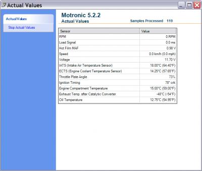

I've started playing with my Durametric software. Most of the items I can log make sense, but there are 3 that haven't been translated from German, and there are others that are either redundant or just don't make sense to me. So...
Is there any info online on what the various loggable parameters are? Something akin to the tutorial I wrote for the Chevy LT1 ECU?

The logging parameters are slightly different for DME 5.2.2, DME 7.2, DME 7.1.1, and DME 7.8.
Then added many new logging features in the DME 7.8.x used in the 987 and 997 series cars.
I have never seen these well written up by Porsche or Bosch.

Someone asked this question via a PM so I thought I would share the answer here...
"When I floor the pedal, the Throttle Plate Angle says 80%... is it supposed to be 80%? Or am I missing 20%?"
That reading is correct.
Here is the Durametric Software reading (on my car) and the reading I took with my PST2.
Also, here is the test from the OBD II manual:
QUOTE
  Quote
Read actual values for TP sensor.
1. Connect and switch on Porsche System Tester 2.
2. Select vehicle type 996, DME, Actual values.
3. Select TP sensor.
4. Read actual value with throttle valve closed. Display: approx. 0 %
5. Fully depress accelerator pedal.
6. Read actual value with throttle valve open. Display: approx. 70 - 80 %
Note: It is important that the value changes and does not remain fixed.
