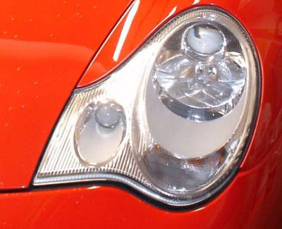

The 02 has the projector type headlight units (see below) and the pattern has a sharp
horizontal cut off similar to our Xenon equiped 3 series BMW. The pattern is also much wider
compared to typical US style beam patterns. I believe this is the cause of apparent
lack of lighting, it's spread out more. When I first got the car I pulled over to
see whether the lights were actually working. High beams are fabulous though.

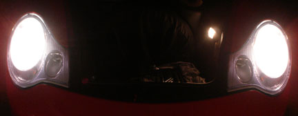

I already tried the Sylvania Silverstars and found the improvement underwhelming:
Can you tell the difference?

Before you dismiss this post, I have searched this and other news groups for this topic and have not
found a definitive answer. Most of what I have found is relevant for pre 02 cars
that can be retrofited with the Litronics kit or pertains to retrofitting non projector type headlights.
I am looking to improve the lighting on my US 2002 996 C2:
1) What is involved with a stock bi-xenon retrofit?
What is the final word on the autoleveling and wiring?
2) Regarding the HID retrofit kits (e.g. http://www.xtralights.com/index.asp?PageAc...PROD&ProdID=14)
o What are the long term effects on the lens, mirror and headlamp housing?
Any personal experiences?
HIDs use 35 Watt bulbs, supposedly produce less heat but output more light in the visible range.
o What are the effects on the beam pattern?
The HID bulbs are longer and therefore may mess up the beam pattern.
What are your experienes?
Note:
Thanks.
