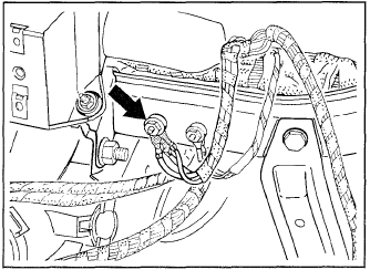

One Tiptronic ground point is located in front of the instrument cluster on the dashboard support frame.

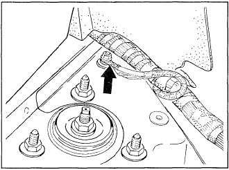

The other Tiptronic ground point is located on the rear wall in the rear luggage compartment, between the DME control module and Tiptronic control module.

I found the first and second points you mentioned.
- the one under the dash and the one on the back wall. However, the second picture (supposedly of the back wall one) shows one that is near the strut tower. I cannot locate this ground. There is a black film that is glued down around the tower, and I am nervous to pull it up. Is this where i should be looking? Also, I could not locate the plug near the passengers lower seat belt... is it beneath thte carpet? Or are you refering to one of the plugs in the drivers side, rear wall of luggage?
