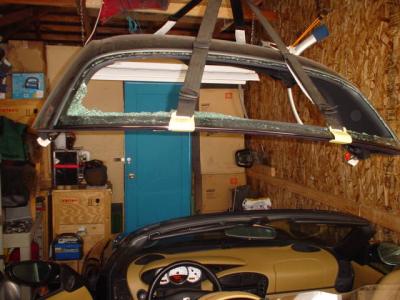

This is how to replace a broken rear window for your hardtop. I broke mine when
it was hanging from the hoist in my garage. I accidently had a small piece of 2X4 fall
about a foot onto my hardtop window and shattered it to pieces. I was very surprised
how easy it was to break. Approx 1/2 of it immediately fell out of the window. I knocked
the rest out so it wouldn't fall on the top of my car. All that was left was the edge that
was glued to the top with about 1/4 inch of shattered glass. You an imagine I was pretty
sick when it happened as I knew I just spent a chunk of money to get it fixed.
I showed toolpants so he could take a picture of it hanging in my garage with the
broken window. I didn't take any pictures of the process as it's just as described in
the manual. The glass was $568 + tax from the dealer. I had a 10% off parts coupon
