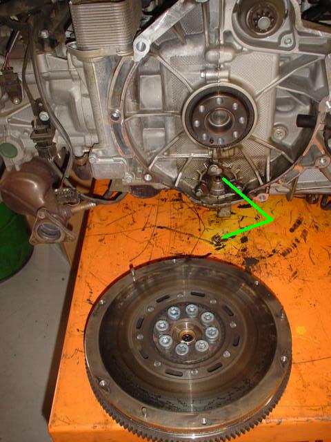

This is a 2003 2.7 Boxster where this happened. The threaded end of the shaft sheared off with the nut still attached. I was told this happens because Porsche switched from a double roller bearing to a single at the end of the shaft. The top green line is the shaft. The bottom is the broken end with the nut.
