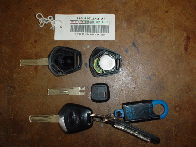

A new remote comes with a paper tag with a series of numbers on it. I think it is a 24 digit code, not 16. Without that tag it is worthless.

If you are using your old black key head, and simply inserting a new metal key shaft, then your key head is already programmed to your car. You're good to go once it comes to the parts department.
If you are starting with all new parts, then it works this way:
1. New metal key shaft can be ordered from any dealer by supplying your VIN (with proof of ownership).
2. Then, choose between:
A. New auxillary key head (no remote locking) with internal immobilizer for which your can must be programmed (mated) using the PST2; or
B. New remote locking key head which must have internal immobilizer AND remote locking transmitter mated to your car using the PST2.
In the mating operation, the dealer must use a super secret code, specific to your VIN, which he will get from PCNA .... AND ..... for a remote locking key head, the 16 digit code that is displayed via a bar code tag that comes with each new remote locking key head.
The 16 digit code tag is what is usually mentioned as being included or not included with the key heads you see on Ebay. I've never figured out who buys .... or what they do with .... the heads that are advertised to include no code.

First, you should try a new battery in your remote key head.
If this does not work, then you should search this forum to find the method for reviving a dead remote key head by inserting the battery with reverse polarity .... momentarily .... and then reinserting it properly. This may revive your remote.
If not, you need to buy a new remote head to go with the metal key shaft you already have. The procedures to get this new remote head mated to your car are detailed exactly in the post immediately above yours in this thread.

A key head without a code tag is not necessarily useless.
The code can be retrieved from the car that was last programmed to work with the key. But if you bought it on eBay it's unlikely you're going to convince the seller to get the dealer to provide this info.

The key does not "take the program". The key is unaffected by the process. Rather, it is the CAR's computer that is programmed to recognize a new key immobilizer and remote unlocking signal (2 different tasks). This operation requires the PST2 (or newer equivalent), and I have watched through the process.
At the point of mating the key head imobilizer transponder, the program asks for the super secret vehicle code available only from PCNA.
At the point of mating the remote transmitter, the program asks for the bar code from the key head tag.
Point of trivia: for MY2000, at least, the car's computer can accomodate 5 imobilizer transponder signatures. If a key is suspected stolen, the old key transponder signature can be erased from the car computer's memory .... to make it incapable of starting the car (key will turn, but car will not start). If one is simply adding a new key head, then this step can be skipped .... unless removing a key is necessary to make room for the new one.
