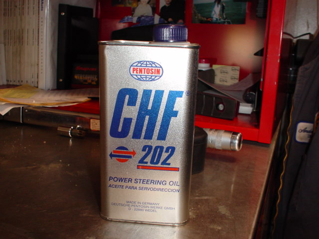

Just called Sunset imports where I ordered the new can of Pentosin; the say that Pentosin CHF 202 in the silver can replaces and is compatible with Pentosin CHF 11S.
I know CHF 11S because I have a seal leak in my 1997 power steering rack and have gone through almost three 1 liter cans over the years. It is in a green can with a red cap.
Never heard of CHF 202 and I could not find it on the Pentosin site. http://www.pentosin.de/eng/index.html
So I called a mechanic at my dealer. CHF 202 is new the replacement fluid for both 986/987. He said it comes in a silver can with a blue top.
Update: The mechanic showed me a can of CHF 202 today. It says right on the can that it can be mixed with CHF 11S.
