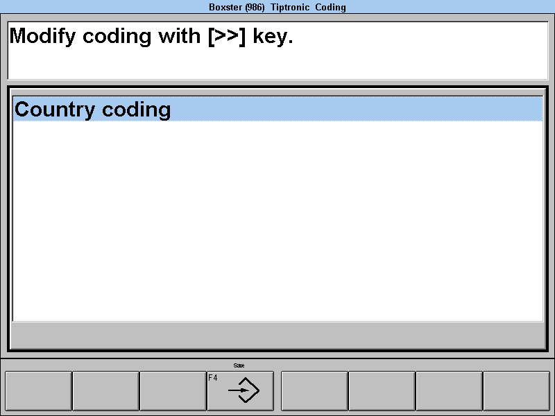

That is not uncommon at all. The DME will log events that are pending codes as well as triggering codes. Either can be cleared if the condition that caused the code is corrected. This is done in a certain number of drive cycles depending on the code. That is why a loose gas cap CEL will eventually clear itself (assuming you tighten the gas cap).
Also, does the PST2 produce a readout? Should I ask to see it? What should I look for to insure that they are actually using correct equipment?
Yes, the PST2 can record screen data and readings. The tech has to push a "save" button on each screen they want to record in the PST2 log. Then they have to print the log. In some cases (specifically warranty work that is requesting reimbursement) Porsche requires the log be sent in.
Here is an (very short) example log:
PST2_log.pdf
