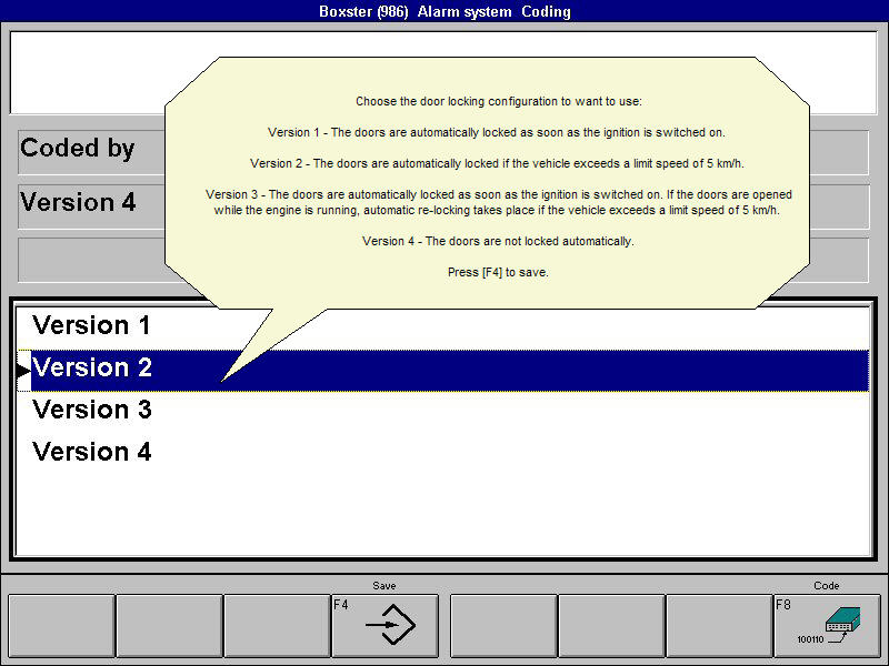

After coming back from dealer service, my doors no longer lock automatically as I set off. The manual talks about getting the dealer to set the option, is there any way this can be done without me going to the dealer?
You will need to find a dealer, independent shop, racer, or other private individual that has a PST2 or PIWIS Porsche tester. Where are you located?

I'm in the UK, it's a nonsense that the user cannot change this at will.

Loren,
Can the Durametric software change this option?
