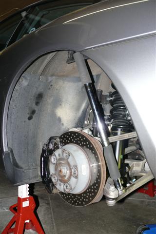

Anybody know what type of spring compressor is being used in this DIY? It's nice. Or can someone recommend one, maybe post pics of tool? Thanks

To answer Coleta's question in post #47...the spring compressor appears to be a Sears one. That's where I purchased mine, which looks identical to that shown in the DIY procedure. It worked very well.
