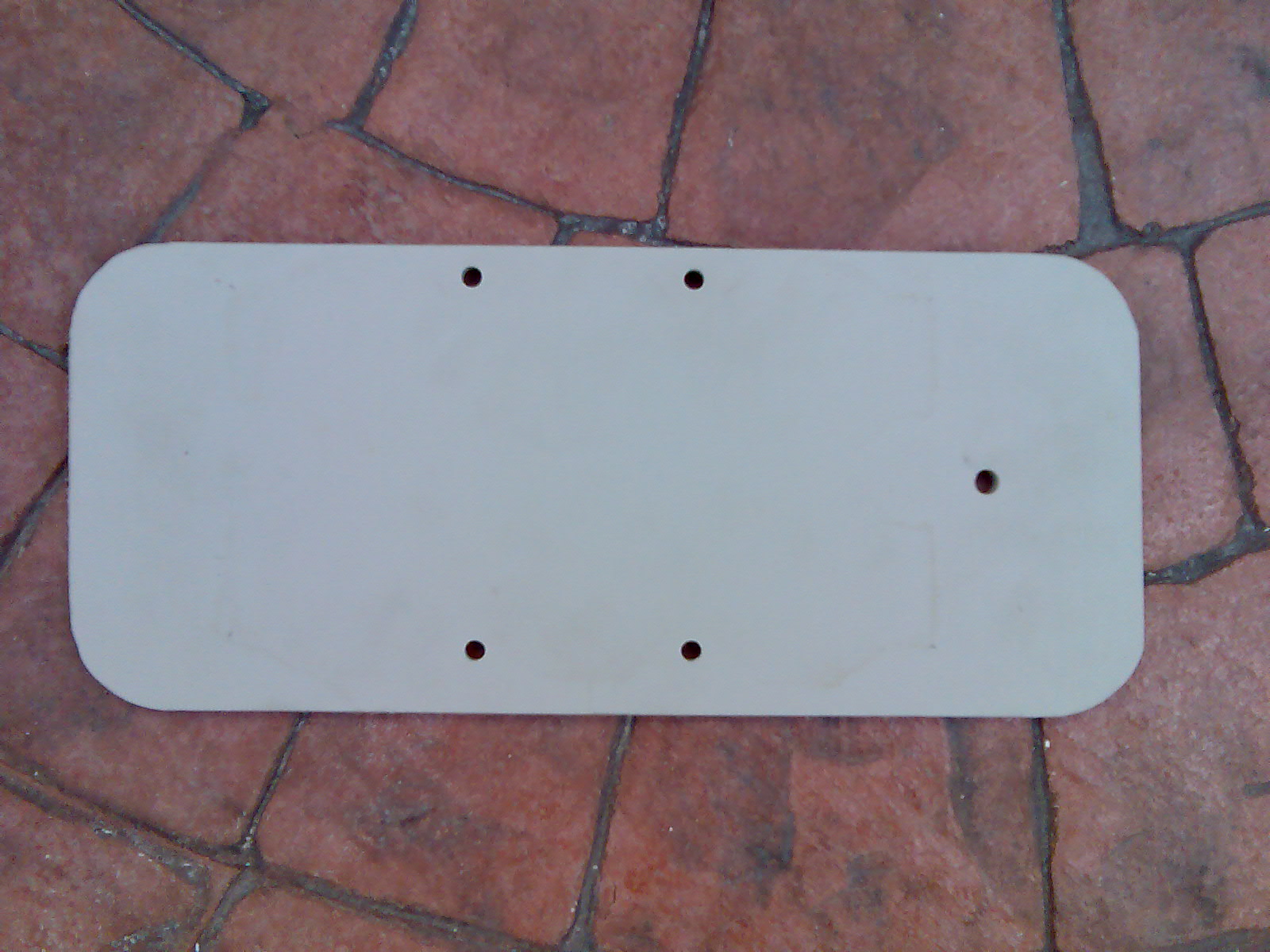

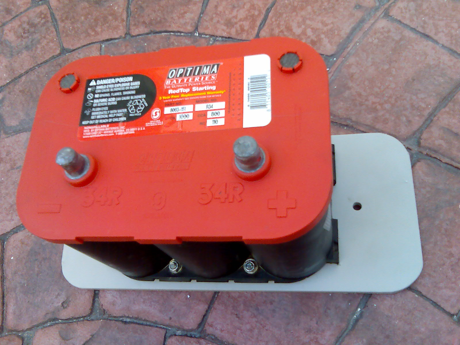

Good instructions Oggie... :clapping: worked for me. Thank you. I used Starboard from a boating supply store (about $30) and rounded the corners with a Dremmel tool. Here are some Pics...
I made two adaptor plates, one for me and one for a friend, but he might be selling his car so I might list it on the for sale forum.

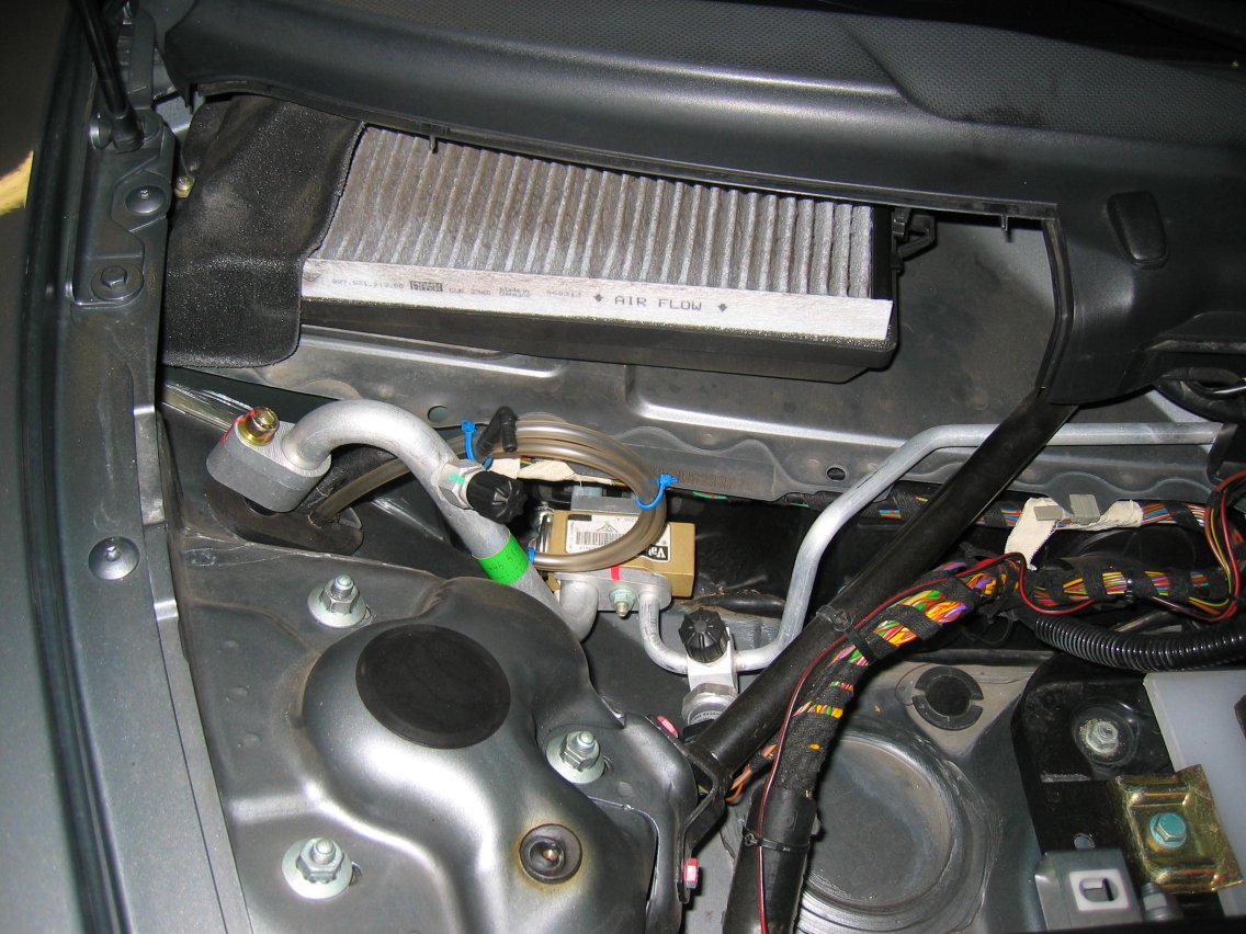

I was recently asked about the vent tube and where I put it, so thought I'd post the pictures here in case anyone else needs them in the future.
Here's how the vent tube looks after I coiled it up. It's to the far left of the battery area (i.e., passenger side when standing at front looking back toward the battery). You need a T-25 Torx driver to remove the screw holding the black plastic cover to gain access

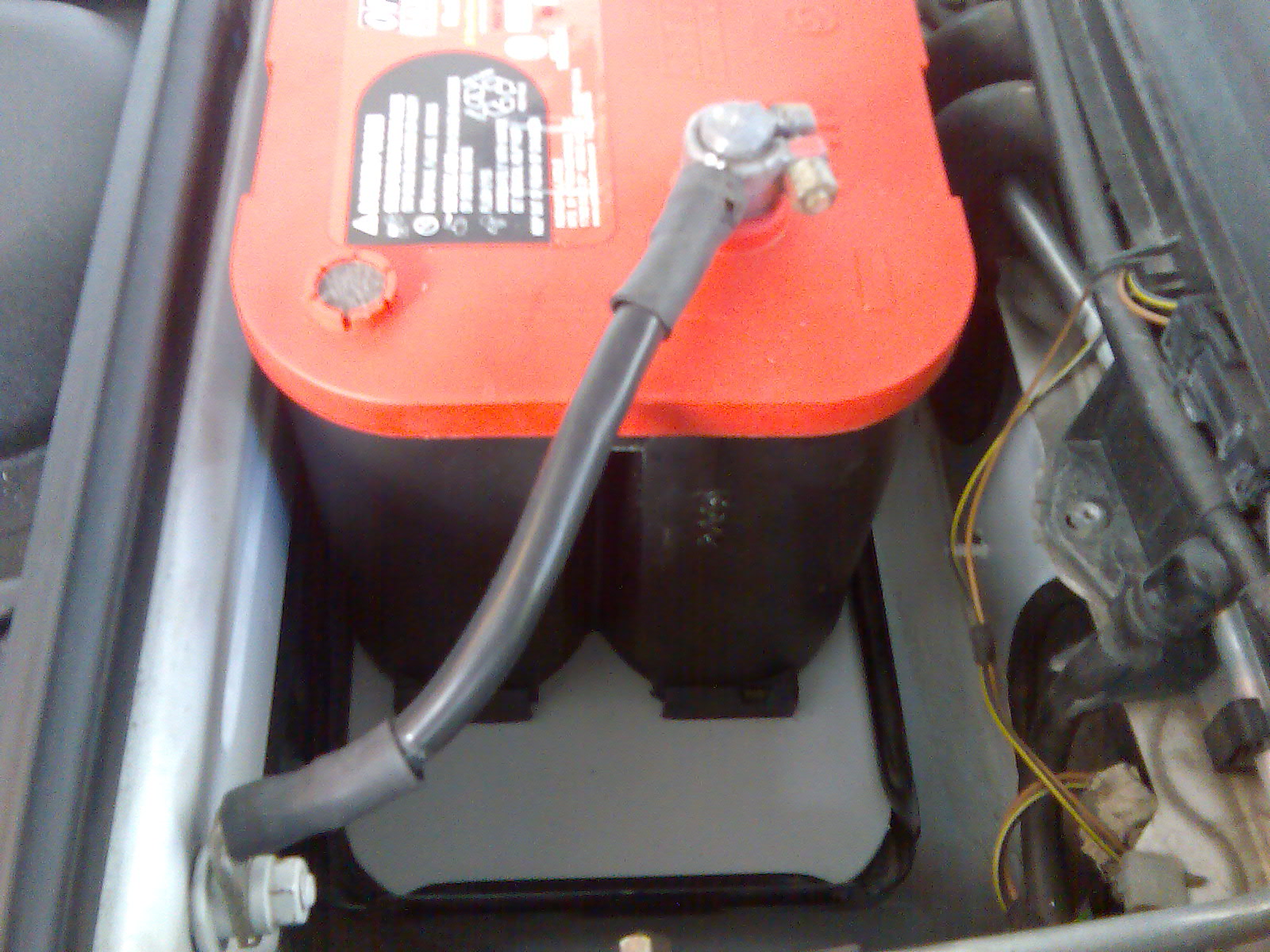

And for comparison, here's a picture showing how my Optima mounting base is held down using the stock hardware
