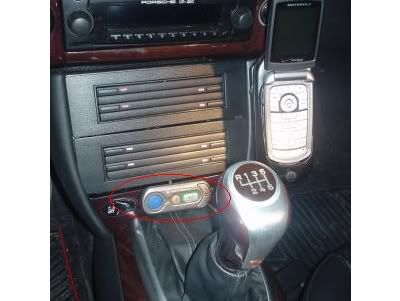

I am looking at installing a motorola bluetooth kit in my 2001 996 cab (looks like the same kit hspiva used here http://www.renntech.org/forums/index.php?s...luetooth+phone). I was thinking about taking apart the control unit (circled in red)
and hijacking some tip switches to perform the functions of this device. I have 3 blanks on my car (no PSM :o ) and this would take care of the 3 controls, but there is a volume control that I'm not sure what I should do with. I was wondering if anyone knows whether it is likely this would be a successful venture?

I had the same thought as Ben regarding the swithces. I even found a site offering an interface kit to play the Motorola BlueTooth (HF1000, I think) thru the Porsche sound system. Decided it was way too hard to justify for my limited amount of car phone use.
BUT...would likely buy it if a smart guy put together a kit with (or for) Porsche switches for a reasonable price.
